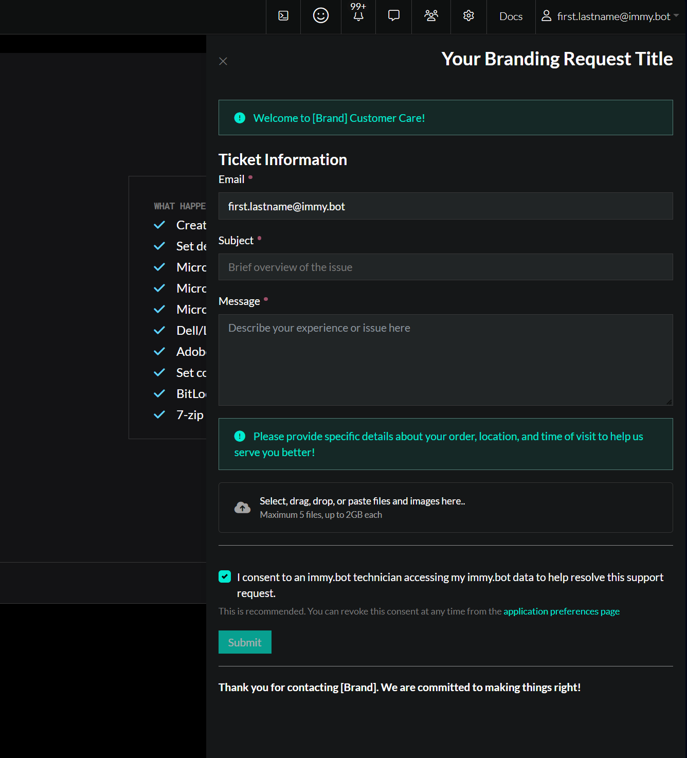

  4. (Optional) Add the -NewSupportFormBranding parameter to adjust the behavior and branding of UI elements used in the ‘Support Sidebar’ and/or the ‘Session Support Request’ modal. See UI Example

    # Replace the default Immybot Support Sidebar and Session Support Modal UI details with your own branding
    # Available parameters:
    # - $supportSidebarTitle: The title of the support sidebar panel
    # - $headerAlertMessage: The text residing in the alert at the top of the support sidebar panel
    # - $descriptionPlaceholderText: The placeholder text for the description field in the support form
    # - $descriptionAlertMessage: The text residing in the alert under the description field
    # - $showConfirmationCheckbox: Boolean indicating whether to show the 'I've read FAQ' confirmation checkbox
    # - $footerMessage: The text residing in the footer of the support sidebar panel
    # - $sessionSupportButtonTitle: The title of the button for the session support modal
    # - $showSessionSupportConfirmCheckbox: Boolean indicating whether to show the 'I've read the Security Software Exclusions' confirmation checkbox in the session support modal
    New-SupportFormBranding -SupportSidebarTitle 'Your Branding Request Title'
                            -HeaderAlertMessage 'Welcome to [Brand] Customer Care!'
                            -DescriptionPlaceholderText 'Describe your experience or issue here'
                            -DescriptionAlertMessage 'Please provide specific details about your order, location, and time of visit to help us serve you better!'
                            -ShowConfirmationCheckbox $false
                            -FooterMessage 'Thank you for contacting [Brand]. We are committed to making things right!'
                            -SessionSupportButtonTitle 'Request Help'
                            -ShowSessionSupportConfirmCheckbox $false

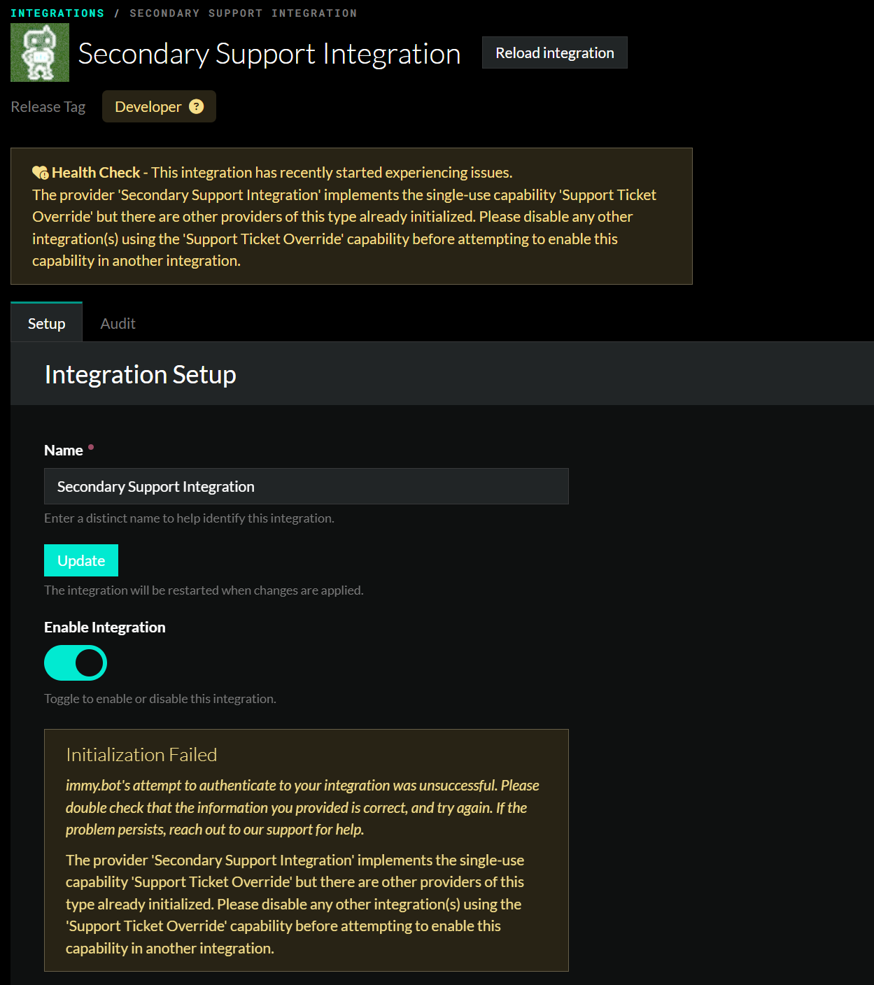

Enabling Multiple Support Ticket Override Integrations
This is an example of a warning you will receive when a second integration with the ISupportsSupportTicketDetailOverride capability is enabled. To resolve the issue, disable the current integration. Navigate to the previous integration implementing this support override capability. Disable and Update it. Then navigate back to the desired support override integration you wish to enable and enable/update it.
UI / Branding Change Example
ConnectSecure
Acronis
