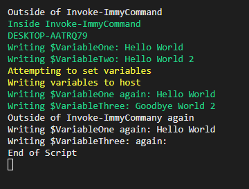

How do you pass variables to Invoke-ImmyCommand?
To pass variables from your meta script to Invoke-ImmyCommand, reference the variable like this:
$using:VariableName
Example:
#Set your variables
$VariableOne = "Hello World"
$VariableTwo = "Hello World 2"
#Do things outside of Invoke-ImmyCommand
Write-host "Outside of Invoke-ImmyCommand"
#Invoke-ImmyCommand to do things on the PC
Invoke-ImmyCommand -Timeout 600 -scriptblock {
  Write-Host "<code>{{EJS126}}</code>$VariableOne: $using:VariableOne" -ForegroundColor Green
  Write-Host "Writing <code>{{EJS127}}</code>$VariableOne again: $using:VariableOne" -ForegroundColor Green
  Write-host "Writing <code>{{EJS128}}</code> of Invoke-ImmyCommand again"
Write-Host "Writing <code>{{EJS129}}</code>$VariableThree: again: $VariableThree"
Write-Host "End of Script"
Output: alt text
