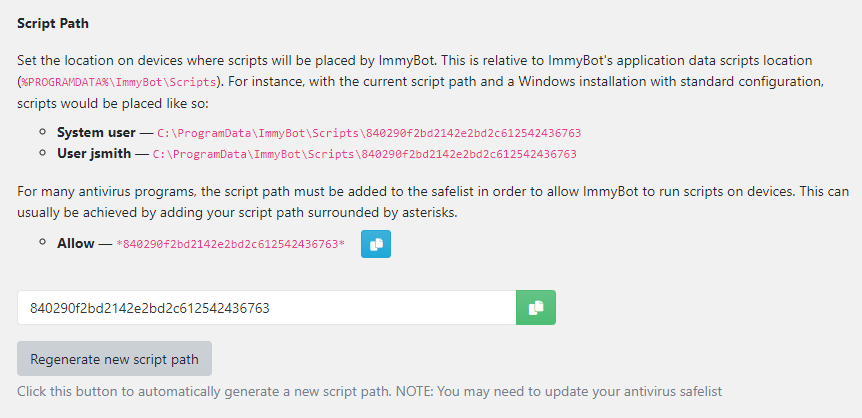

Exclusions based on code signing certificate are an industry standard feature and should be a standard feature in any best-in-class security software. However, if your security software is unable to exclude based on code signing certificate, create an exclusion for your instance’s Script Path.
Finding the script Path for your instance
Your script path can be found under Settings -> Preferences -> Script Path

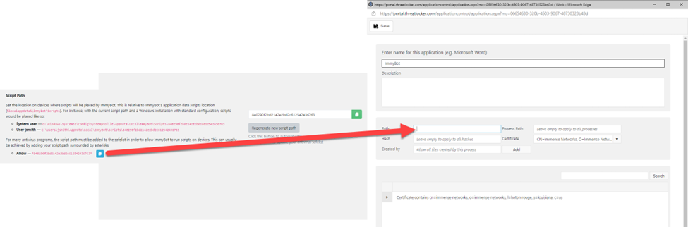

ThreatLocker
  1. Application Control-> Applications
  2. Create New Application
  3. Put the following value into Certificate and click Add
Warning
ImmyBot’s current code-signing certificate is set to change on Feb. 11th, 2025. Please add both our upcoming and existing certificate exclusions to ensure no issues.
Please see the FAQ section for more details
This certificate is used to sign our Agent binaries & installers delivered to machines.
Unfortunately, our new certificate’s Organization(O) and Common Name(CN) fields are changing from Immense Networks to ImmyBot LLC.
New Certificate on Feb. 11th, 2025:
CN=ImmyBot LLC, O=ImmyBot LLC, L=Baton Rouge, S=Louisiana, C=US
Existing Certificate:
CN=Immense Networks, O=Immense Networks, L=Baton Rouge, S=Louisiana, C=US
Add both certificates to avoid issues if following before Feb. 11th, 2025 OR your instance has existing machines installed (which may have agents installed with older certificate)!
  1. Add your instanceโ€™s script path
    Ultimately it should look like this:

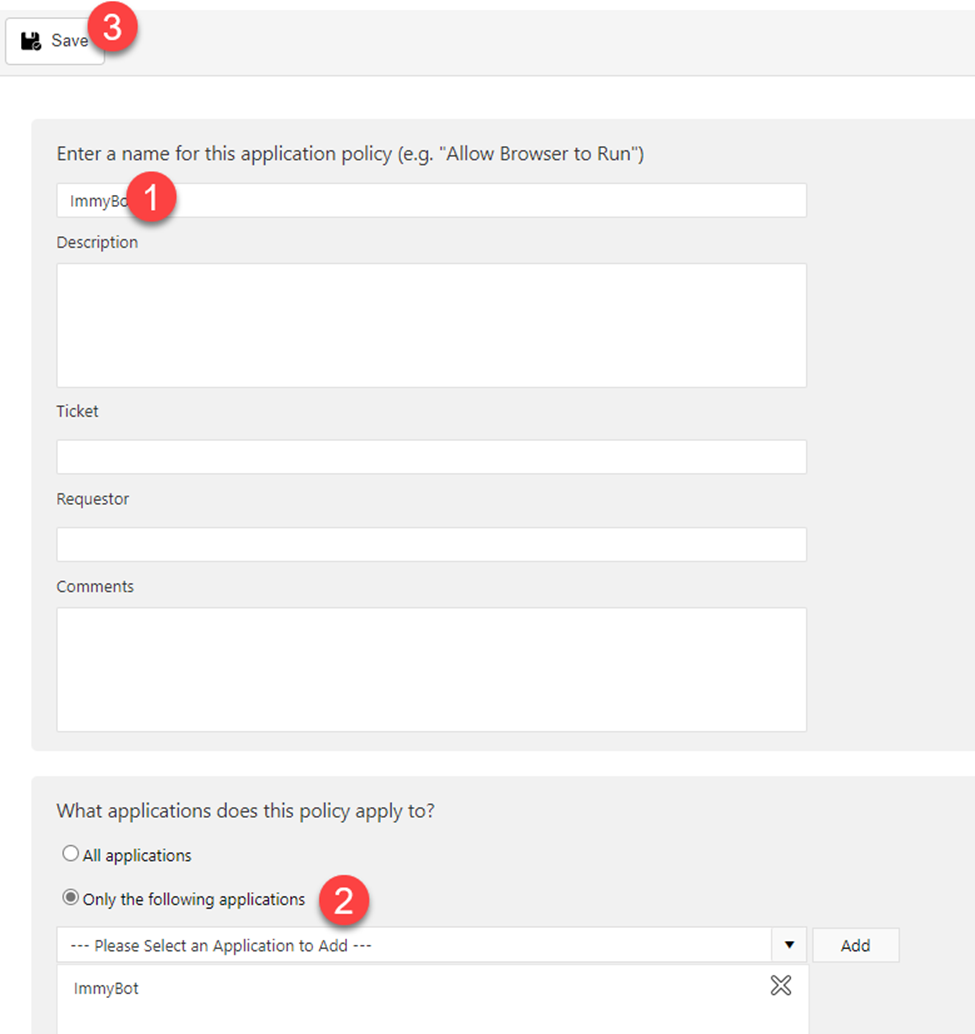

  2. Create a New Application Policy

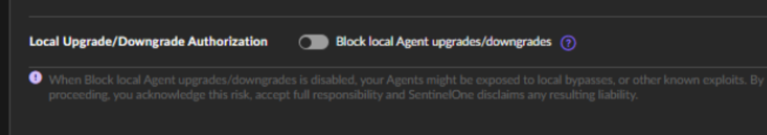

Updating SentinelOne through ImmyBot
If you want ImmyBot to handle SentinelOne updates, you must disable “Local Upgrade/Downgrade Authorization” found in:
Sentinels > Policy > Agent
